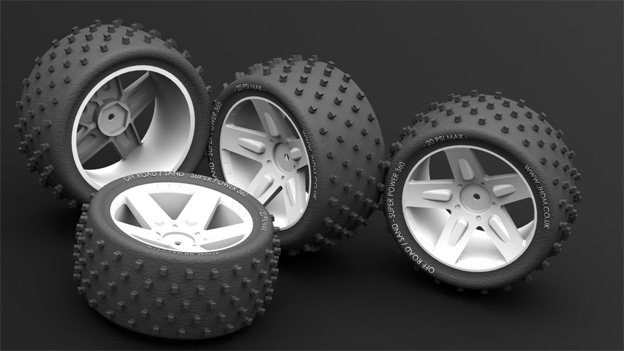

So, there are a lot of aspects that go into creating a very accurate, highly realistic rendering. You pick up tricks along the way, how to look at models in the context of reality and use composition to frame your rendering. To get you started down this path, I’m going to share some rendering tips that will help improve your rendering skills using SolidWorks Photoview 360.

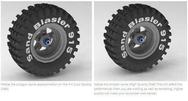

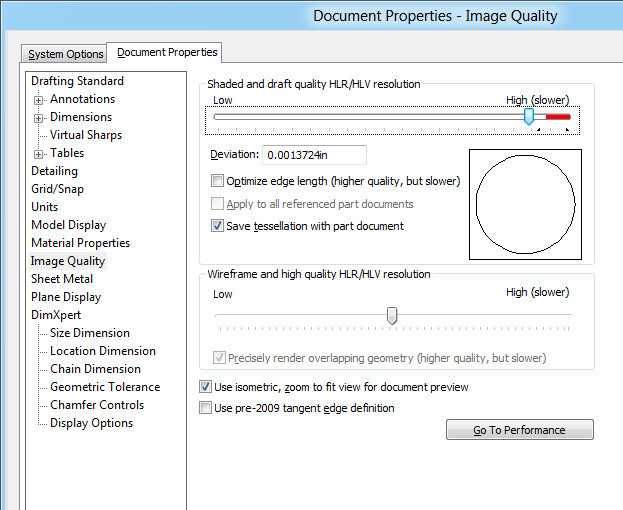

1. Adjusting the Image Quality
First of all we need to do a little setup, once you have an open part or assembly document go to the OPTIONS button, choose the DOCUMENT PROPERTIES Tab, and finally select IMAGE QUALITY. You will see this screen. By selecting a high draft quality you will get smoother curves in the model, as well as in your rendering.

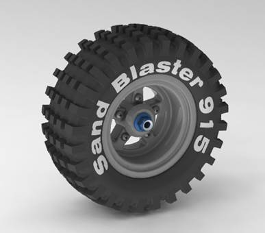

Another important feature is choosing the right materials. The best approach to doing this is capturing the lighting in what you are rendering. Sounds odd, but remember, plastic does not always look like plastic. The color red to many people looks more like brown. It all depends on the lighting you want to show the rendering in.
For example, in the previous rendering, I knew the tires are rubber, the wheels are made of plastic (low gloss) and the nut is anodized aluminum. Those Appearances exist in SolidWorks, but sometimes the look and the color will need adjustments depending on the lighting you are using.

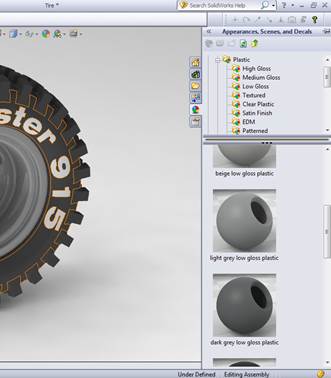

As you see here, a Part or Assembly Apperance is selected from the SolidWorks Taskbar. You can select a face, feature, body, part, or assembly and then add an Appearance or you can drag and drop an Appearance from the Taskbar onto a part. This applies the Appearance to the entire part.

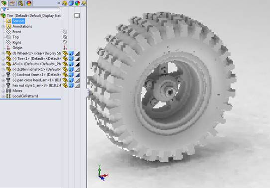

You also need to realize that there can be a top level Appearance (in an assembly) that can override a lower level Appearance (in a Part) as shown in the image below.
Here you can notice that even though I choose the appearances for each part (lower levels) the assembly appearance (white) is replacing all of them (top level).

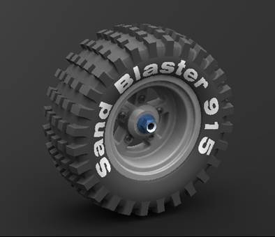

Once you are comfortable with the chosen Appearance, we need to move on to the Scene, which adds an Environment and Background to your rendering. The scenes I recommend are Black with fill Lights, Grey with Overhead Lights, and Soft Spotlight. Each of these Scenes has its own Environment and Background.
Black With Fill Lights
Soft Spot Light

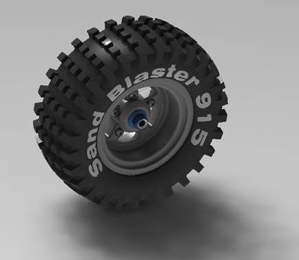

Notice how the Background and shadows change? You need to compare which Scene best accentuates the model, the composition and the lighting. Are you beginning to see the aspects that go into producing an amazing rendering? Excellent!

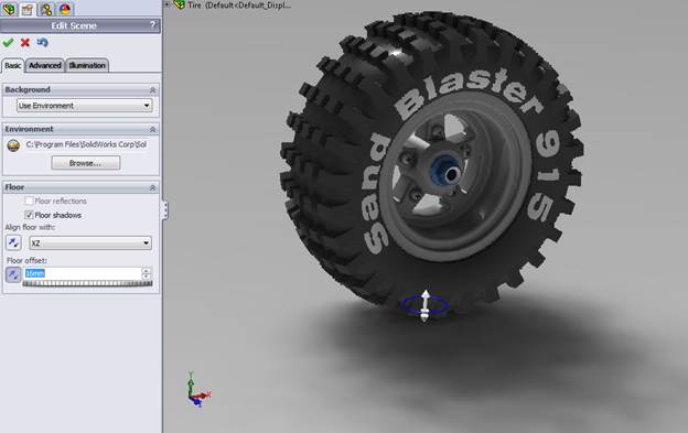

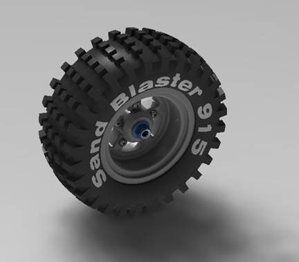

Sometimes you model may be “floating” off the floor casting a shadow away from the model. This means the floor in your Scene isn’t located correctly, but it’s simple to adjust. To change the floor offset simply go to the Display Manager Tab (multi-colored ball) on the left sidebar. Right-click on Environment, and then select Edit Scene. Near the bottom, you will see the Floor Settings. You can select the plane you want your floor to be and offset it to fit your needs.
Adjusting the floor offset allows you to move the floor to the desired location of the model.

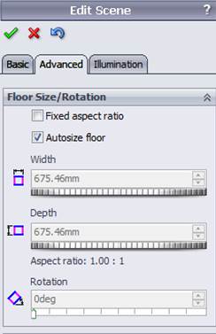

Another interesting feature comes in the Advanced tab inside the Edit Scene Dialog, here you can add a little more adjustment to the Scene, setting the Environment size and orientation. All of these setting, however, will not be seen in the SolidWorks window. To see adjustment to the floor, the floor size and rotation and the illumination, you will need to bring up the PV360 Preview Window or use the Integrated Preview. Both of the options can be toggled on and off from the Render Tools tab or the PhotoView 360 menu.
Edit Scene Dialog, Advanced Tab.

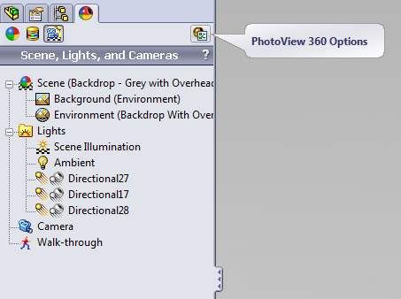

From the DisplayManager Tab, select Photoview 360 Options.
Display Manager Tab.

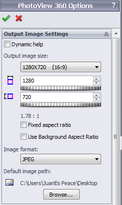

Under Output Image Settings you can select an image size for the final render (the higher resolution the longer the Rendering process will take!) as well as the image format and default location for saving them.
For render quality, I typically set Preview render to Good and Final Render quality to Best (or Maximum) with a Gamma between 1.2 and 1.8.
