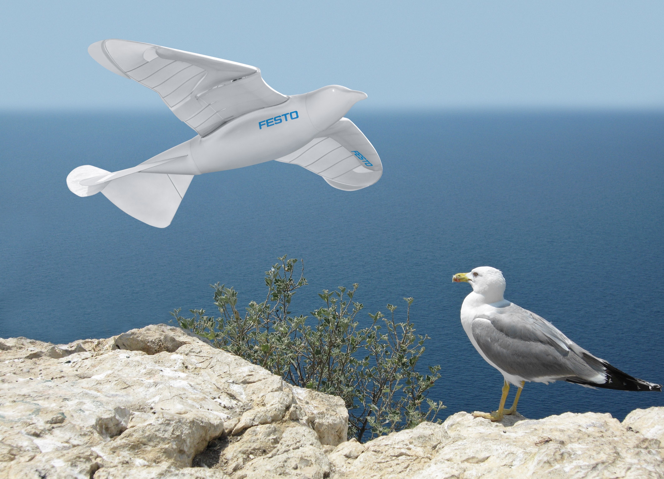

Birds are the most efficient flying “machines” in the world. I had the opportunity to talk to Markus Fischer, Head of Corporate Design in Festo AG & Co. KG, German based engineering-driven company in pneumatic and electric actuators industry. Festo’s SmartBird is an innovative mechanical bird that they recently built to explore bird’s flight and challenges in the lightweight construction.

Markus Fischer: The objective of the project was to construct a bionic bird modelled on the herring gull. The fascination of building an artificial bird that could take off, fly and land by means of flapping wings alone provided the inspiration for our SmartBird’s engineers.

The unusual feature of SmartBird is the active torsion of its wings without the use of additional lift devices. The objective of the SmartBird project was to achieve an overall structure that is efficient in terms of resource and energy consumption, with minimal overall weight, in conjunction with functional integration of propulsion and lift in the wings and a flight control unit in the torso and tail regions.
Further requirements were excellent aerodynamics, high power density for propulsion and lift, and maximum agility for the flying craft.

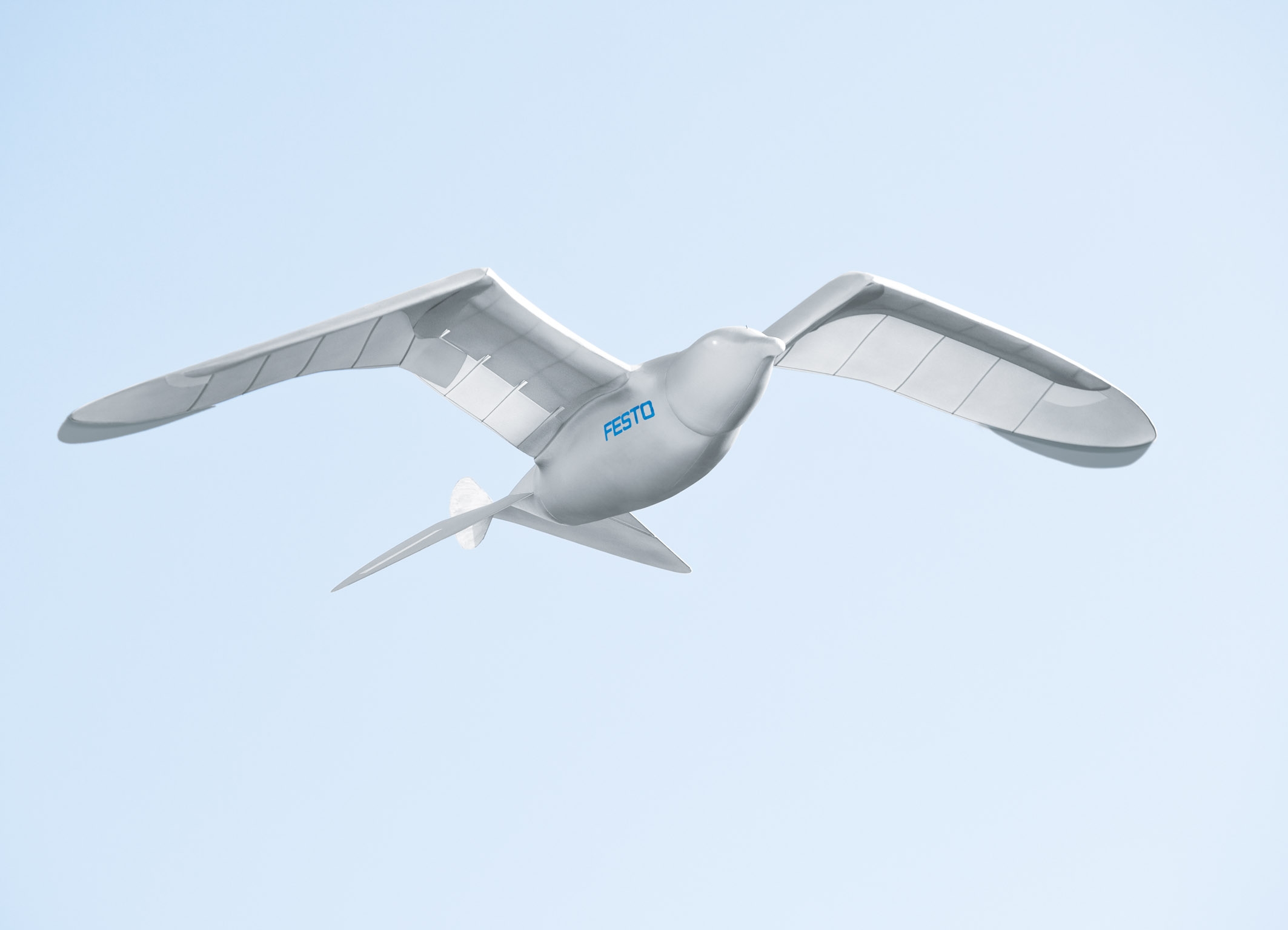

Under scientific supervision, an intelligent cybernetic overall design was realised in discrete individual stages.  Flapping-wing flight comprises two principal movements. First, the wings beat up and down, whereby a lever mechanism causes the degree of deflection to increase from the torso to the wing tip.
Second, the wing twists in such a way that its leading edge is directed upwards during the upward stroke, so that the wing adopts a positive angle of attack. If the rotation were solely due to the wing’s elasticity, passive torsion would result. If on the other hand the sequencing of the torsion and its magnitude are controlled by an actuator, the wing’s torsion is not passive, but active.
SmartBird’s wings each consist of a two-part arm wing spar with an axle bearing located on the torso, a trapezoidal joint as is used in enlarged form on industrial excavators, and a hand wing spar. The trapezoidal joint has an amplitude ratio of 1:3. The arm wing generates lift, and the hand wing beyond the trapezoidal joint provide propulsion. Both the spars of the inner and the outer wing are torsionally resistant. The active torsion is achieved by a servomotor at the end of the outer wing which twists the wing against the spar via the outmost rib of the wing.

Markus Fischer: For the SmartBird we used:
  • a lightweight carbon fibre structure,
  • for the lining an extruded polyurethane foam,
  • lithium polymer accumulator,
  • 2x digital servo units with 3.5 kg actuating force for control of head and tail sections
  • 2x digital servo units for wing torsion with 45 degree travel in 0.03 s
  • Microcontroller: MCU LM3S811, 32-bit microcontroller@50 MHz, 64 kByte flash, 8 kByte RAM
  • Radio transmission: 868 MHz/2.4 GHz two-way radio transmission based on ZigBee Protocol
  • Motor: Compact 135, brushless
  • Sensors: Motor positioning 3x TLE4906 Hall sensors
  • Accelerometer: LIS302DLH
  • Power management: 2x LiPo accumulator cells with ACS715 voltage and current monitoring
  • LED activation: TPIC 2810D
