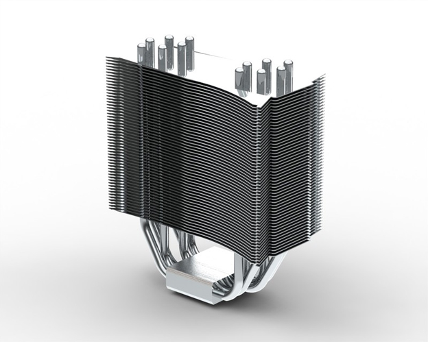

Many processor are also capable of running at much higher speeds than advertised by the manufacture. The process of manually increasing your CPU’s clock speed is called “Overclocking”. With overclocking you can increase your processors performance by changing timing and voltages of the processor to achieve a higher clock speed.
Overclocking often requires improved cooling for the processor such as a larger heat sink or liquid cooling, but can yield significantly improved performance. However, If not done properly overclocking can damage your hardware. So do your homework and proceed with caution! If you are nervous about overclocking, there are several companies that offer pre-overclocked computers with a warranty.
http://grabcad.com/library/thermalright-ultra-120-cpu-cooler

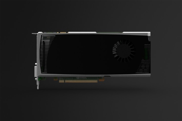

Graphics Card
After the processor, the graphics card (GPU) is considered the second most important piece of hardware. The graphics card handles the visual display of the model when you roll, pan or zoom. For 3D CAD applications you will need a professional, OpenGL graphics card.
There are are two main brands of workstation cards, the NVIDIA Quadro and ATI FirePro series. These graphics cards range in price from $100 all the way up to $2,000+. These OpenGL cards are considerably more expensive than their DirectX based “gaming” counterparts, but are necessary for most 3D CAD applications.
The easiest way to think about the difference between OpenGL and DirectX is an OpenGL card calculates higher detail models at relatively low frame rates, while a DirectX card calculates lower detail models at high, sustained frame rates.
When choosing a graphics card you want to keep in mind the type of work you will be doing. If you work on very large assemblies with lots of models you will want a graphics card with more memory. If the graphics card does not have enough memory, the frame rate will lag or stutter when moving the model. However, most users won’t need more than 256MB memory and can get away with a cheaper card.
It is possible to use DirectX cards for 3D CAD, however some features may not function properly (such as SolidWorks RealView) and you may experience slow frame rates as well as graphical glitches.
http://grabcad.com/library/nvidia-quadro-4000
