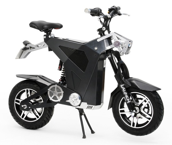

Exo Neutrino (www.exo-bikes.eu) is a tiny electric scooter that handles like a bike, accelerates like a pocket rocket, drives you 40 miles / 60 kms in one go, and fits into the elevator. Designed with the environment in mind it’s the perfect urban companion.

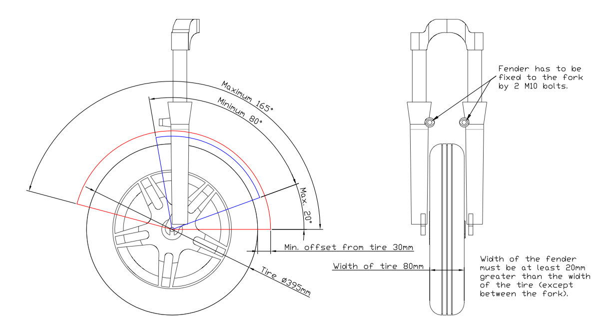

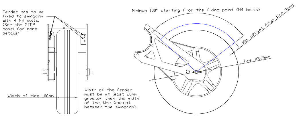

The challenge is to redesign the current plastic fenders on Exobike (drawings and CAD models below). They’re currently done using the extrusion technique and are too fragile and not the best looking. Your goal is to design and engineer new fenders using ABS plastic that will be manufactured by the common molding method.
The requirements
See the drawings for the front end and back end, they contain all the measurements, dimensions, and list the detailed requirements. You can also download the CAD models (front end / back end) featuring the same information.
- Fixing points at places shown on the drawings
- Front fender uses 2 x M10 bolts, back fender uses 4 x M4 bolts
- Tire clearance of 30 mm
- Width of the fender must be at least 20 mm greater than the width of the tire
- Must be easy to manufacture using common molding methods from ABS plastic
- No shorter / longer than shown on the drawing

Design – Neutrino has funky sharp edges and corners, try to match your design to this. But don’t be afraid to try creative approaches.

Is it just me or do the forks in the STEP and the photo not match? In the photo the legs are connected, in the model they are separate. This would have a big effect on the design.
Also the way the current front fender is fastened in the photo it doesn’t look like it bolts from the front.

The fenders are said to be made using the extrusion technique.
Looking at the shape it looks more complex than an extrusion. Can someone please clarify the manufacturing process used.
